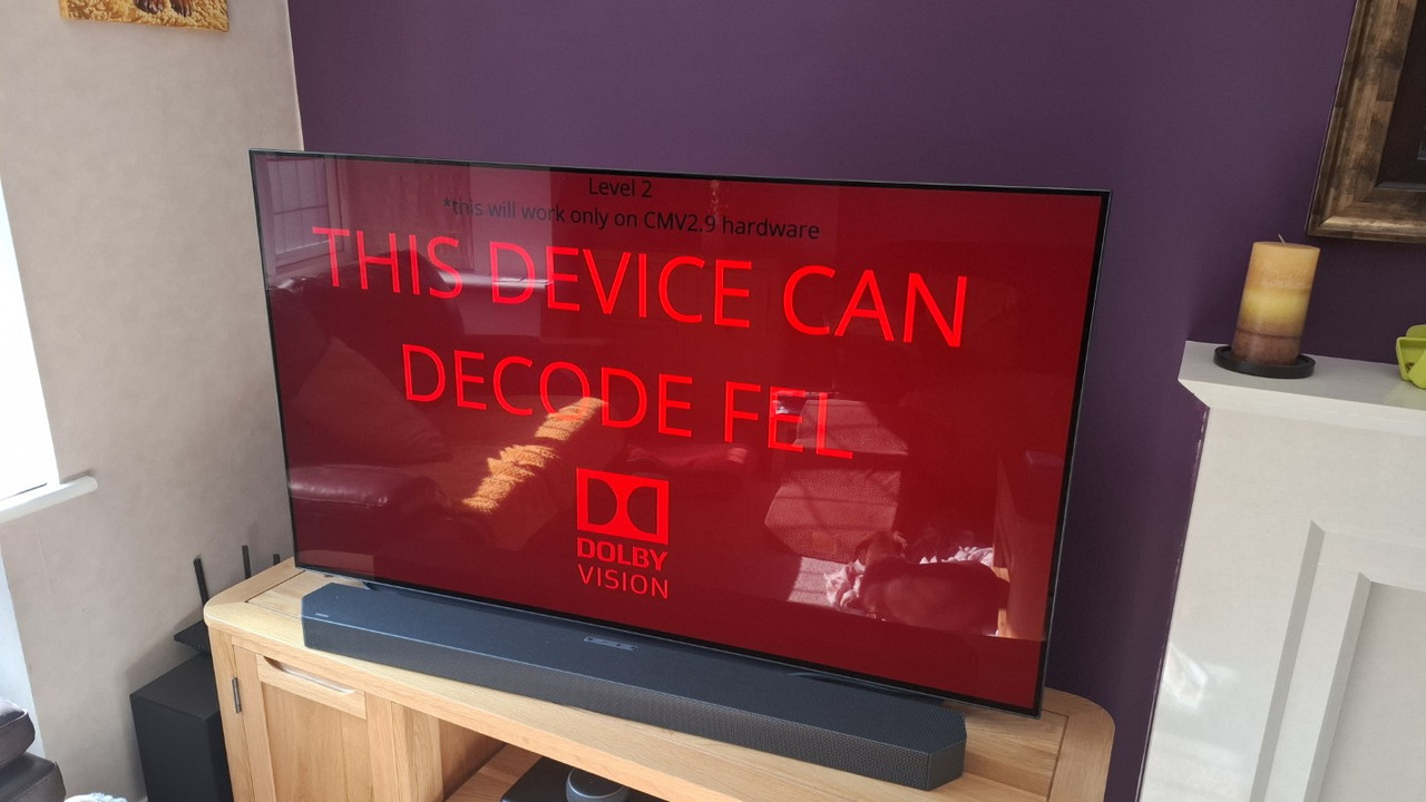

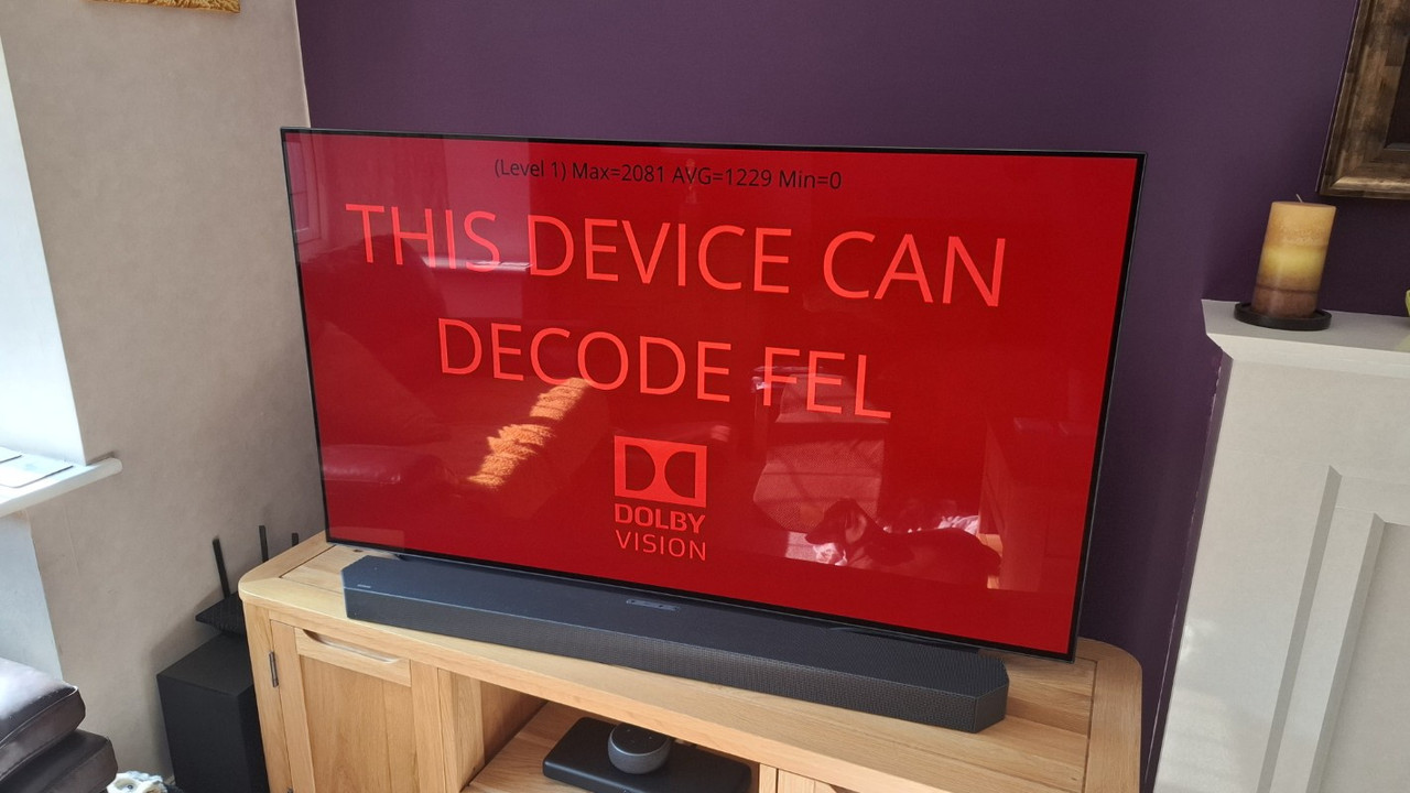

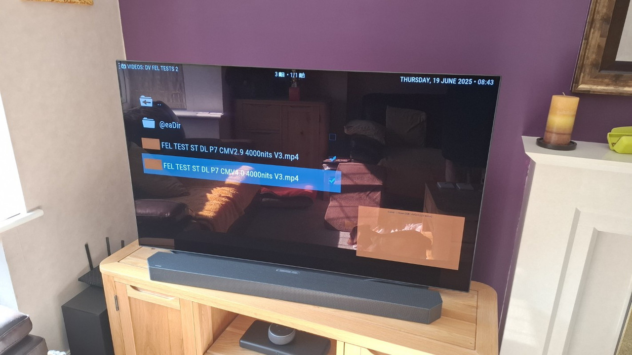

I grabbed some DV test videos which all played perfectly and as can be seen in the images below the play back was spot on. I tried the same 2 videos on a Fire TV Stick 4 Max Gen2 and only a blank red screen is shown as that device (as virtually all other devices) can not play the DV Profile 7 Full Enhancement Layer. The same happened with the other test videos I tried. So, success.
