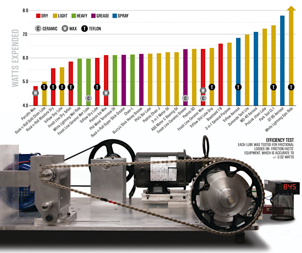

Some documentation on chain lube efficiency tests linked from here: https://ceramicspeed.com/en-eu/pages/chain-lube-efficiency-tests
As you can see, GT-85, as a lube, comes second worst among the products tested in terms of efficiency. I confess I did use it as a lube on my old hybrid, because it was easy. But even WD40 sucks fewer watts.
lubetests.jpgHighslide Image Viewer
I think, apart from the extremely misleading White Lighting Epic Ride, my favourite, just by name, has to be Buzzy's Slick Honey Grease.
I just love these PR departement types, where do they come with these names?
Yeah.
It might be tempting from the results shown above to think that parrafin wax is the easy solution because it's cheap and very effective, but it's also a lot harder to apply. You have to clean the chain very thoroughly, melt the wax at the right temperature then immerse the chain. Whereas one thing that GT-85 and WD40 have going for them is that they're very quick to apply.
