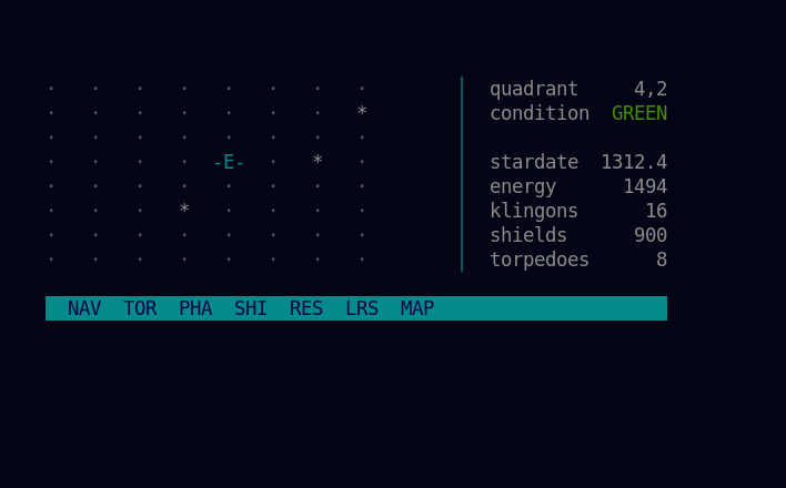

I've created Bash Trek II, a mouse-controlled version of Bash Trek. I started this as an experiment but actually it does work pretty well. Spent hours on it yesterday and today.
st2.pngHighslide Image Viewer
So the blue row is a list of clickable commands and you enter the values using yellow buttons.
Still need to document it and set up a repo on github.

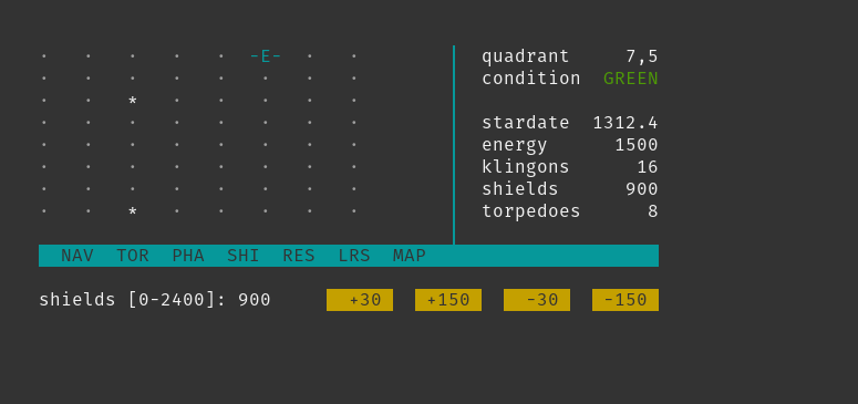

I changed the design of the above, to this:
srs.pngHighslide Image Viewer
The trouble with the first design, although I liked the little "enter" button is that it involves too much clicking around, too much mouse movement.
In this first design, a right click on a number button would subtract, a left click would add and you left-click on the return button to confirm.
In the second - hopefully more ergonomic design - you left-click separate + and - buttons, then you right-click to confirm.
So it's more a Human / Computer Interaction (HCI) problem than a logical one.

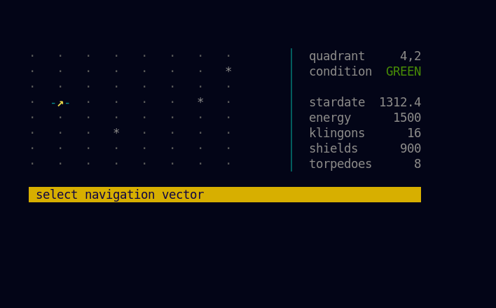

The NAV and TOR commands require a direction to be entered. To enable this, a pointer arrow is displayed at the Enterprise position on the Short Range Scan grid:
nav01.pngHighslide Image Viewer
Left click anywhere to the left of the yellow pointer to click the pointer anti-clockwise one position.
Left-click to the right for clockwise.
Right-click to confirm the vector (direction). You can also left-click on the yellow pointer to confirm.

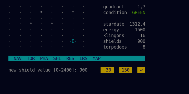

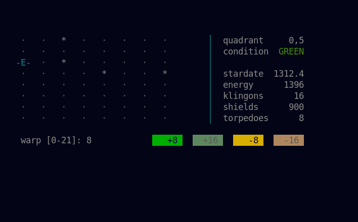

The PHA, NAV and SHI commands require values to be entered (for phaser energy, distance and shield strength, respectively). Again this is done solely by mouse control. The interface is shown below.
nav03.pngHighslide Image Viewer
The buttons to the right of the display allow the input field to be modified by the values shown with a left click.
In the above example the player has entered 8, therefore the +16 and -16 buttons are greyed out (since the permitted value range is 0-21).
The player can left-click the 0 to reset the input field to 0, or left-click the maximum value shown (here 21) to enter the maximum value.
The input field can be incremented or decremented by 1 by using the scrollwheel (forward and backward respectively). The interface doesn't permit out-of-range values to be entered.
The input button states (active / greyed out) are updated with each button click.
The values assigned to the buttons are different, depending on the function. For navigation as above, +/- 8 and 16. For phaser energy, +/- 50 and 200. For shield strength, +/- 30 and 150.
Submit the input value with a right-click.

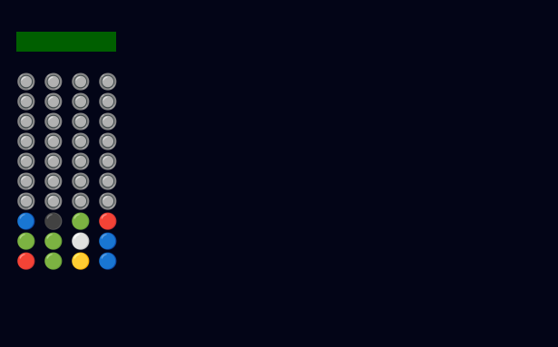

So I started coding it last night, and so far it looks like this:
mm.pngHighslide Image Viewer
I've got the input mechanics (press B to place a blue peg, Y to place a yellow pag and so on, backspace to pull the last one out again). It doesn't do any checking or feedback yet (will appear on the right hand side).
The green bar represents the flap that the secret code is hidden behind in the physical game. It looks a bit rubbish, I may have a rethink about that.
